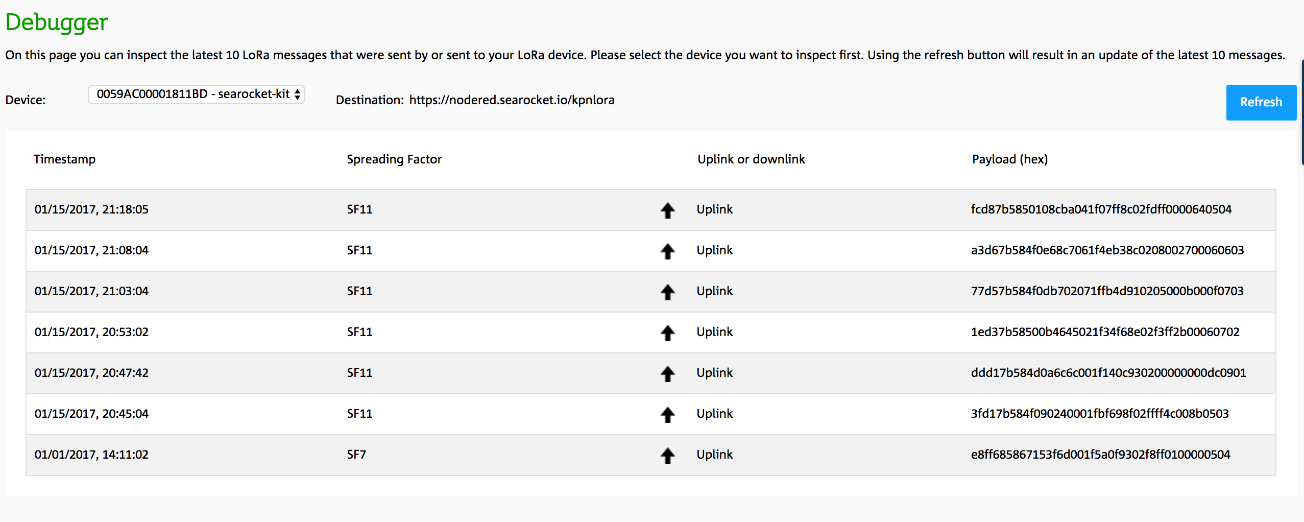

Hi KPN,
I succesfully receive lora packets witin the developer portal, as you can see in the added screenshot.
However, these packets are not received at the given destination endpoint. (a node-red application server). I know this endpoint works because the same evening I also did some tests with the uplink test button in the developer portal, and those messages were successfully received in node-red.
In my proxy logging I see the POST messages of the uplink test but NOT the lora packets from the developer debugger. Therefore, I almost certainly know the KPN source did not automatically forwarded the lora packets to my application server.
Can you help me in troubleshooting this problem?
