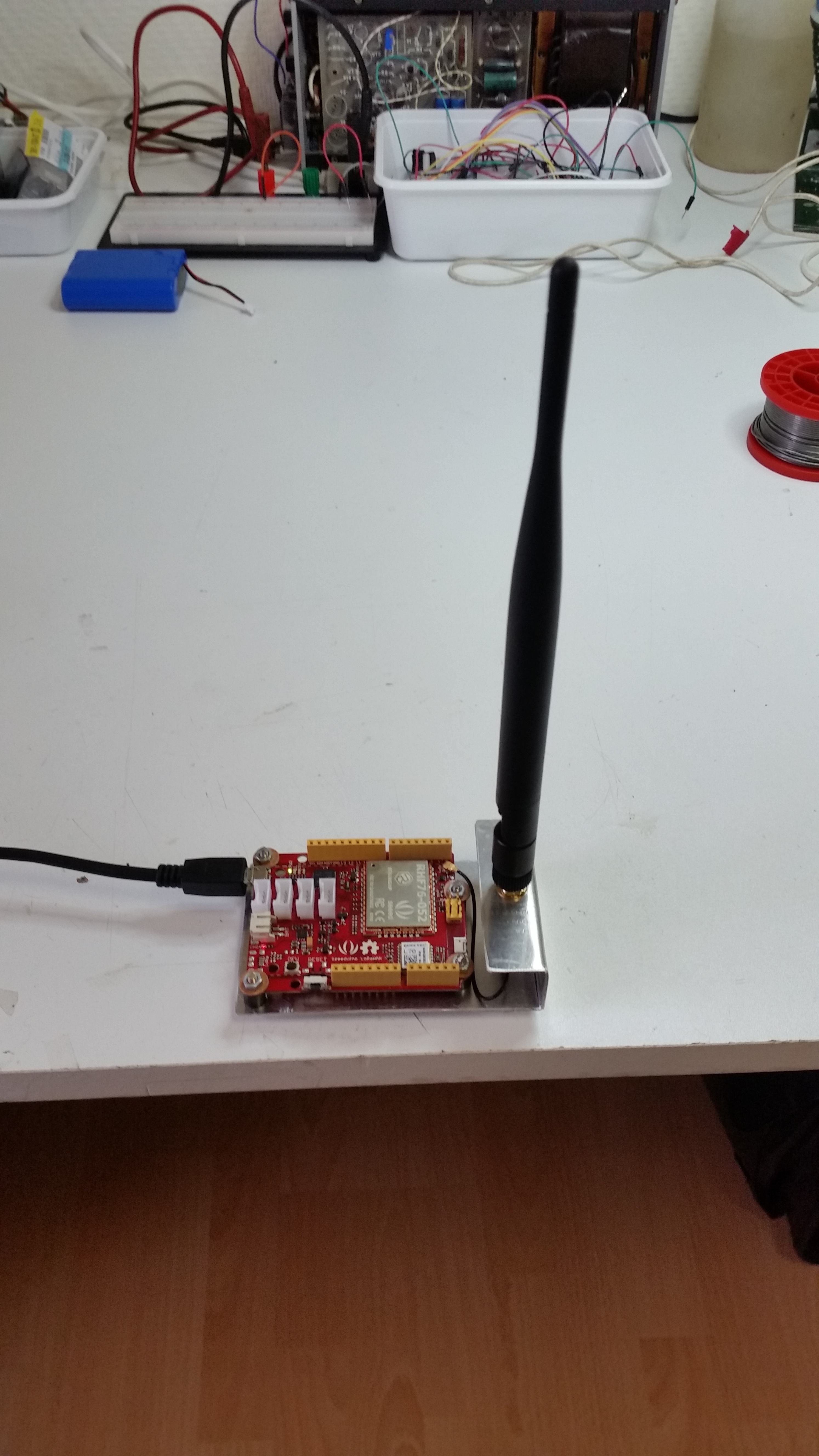

I'm trying to connect a Seeeduino LoraWAN node to the KPN network via the developers portal.
Although I used the settings as given by the portal I do not see it in the portal.
Testing the uplink works, testing the downlink give an error stating no gateway detected.
Is there someone who has used this device or have suggestion?
Thanks in advance,
Jan

This is the serial monitor outpit:
Setup started
Version:
+VER: 2.0.10
DevAddr:
DevEUI:
+ID: DevAddr, 14:20:4C:D7
+ID: DevEui, 00:59:AC:00:00:18:1C:D6
+ID: AppEui, 70:B3:D5:7E:F0:00:35:F3
NwkSKey:
+KEY: NWKSKEY A9 CF 96 06 98 97 C4 EC C3 E0 1F A9 CF 3C 29 41
AppSKey:
+KEY: APPSKEY 5C 84 1B 73 DD 8B FE CA 2E 8B 7E A3 A8 84 E7 70
+MODE: LWABP
+DR: EU868
+DR: DR0
+DR: EU868 DR0 SF12 BW125K
+ADR: ON
+CH: 0,868100000,DR0:DR5
+CH: 1,868300000,DR0:DR5
+CH: 2,868500000,DR0:DR5
+RXWIN1: OFF; 3; 0,868100000; 1,868300000; 2,868500000;
+RXWIN2: 869500000,DR3
+POWER: 20
+PORT: 1
Setup completed
+MSG: Start
+MSG: TX "Hello World!"
+MSG: Done
result is: 1

I'm using an 868Mc antenna (see photo).

Hi Bas,
I tested it upstairs. I have a house that is mainly made of wood, with some brick walls so I expected it to work.
I did run a test outside (see photo) but the device is still not seen.
I see the LED of the RF module blink when transmitting.
